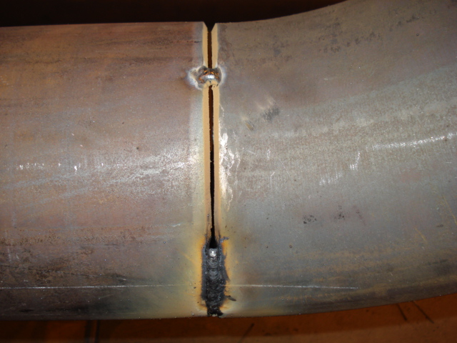

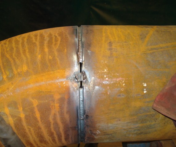

A good trick ifound which would help when doing a no grinding pipe test is instead of using tacks in the normal way on the pipe set you pipe ou with the correct gap prepped etc. and use some m8 nuts or any other nuts place the nut where you want the tack and tack one side to the left pipe and one side to the right, using this method you dont need to worry about burning through the tacks in the root pass as you wont have any just a clean run to weld as you can weld underneath the nut, then you can use a hammer and a chisel to remove the nut when you are finished welding
Parent - - By aevald (*****) Date 05-03-2008 16:50
Hello andrewsullivan9, quite some time ago one of the other folks on the forum mentioned seeing a similar method used while working with some welders from Great Britain. I believe they would use pieces of 1/8" flat bar to tie across the two pieces. The thing about this practice is that it would likely need to have some form of approval to allow for the tacks/welds outside of the weld joint. Are you referring to tacking these nuts across the outside of the weld joint or slightly below the bevel face in the groove? Certainly possible, maybe not allowable. Best regards, Allan
Parent - - By andrewsullivan9 (*) Date 05-04-2008 00:05
Hi Allan im referring to tacking the nuts lengthwise across the outside of the pipe above the bevel , im from the uk myself and picked the technique up here might have been from the same guys even!! It eliminates problems when tying in tacks on the root run i find, ive also worked with pipeliners that have used the other method you were describing of using 1/8flat bar to tie across the outside of the weld joint, i think they were mainly using it to prevent distorsion due to welding
Parent - - By dbigkahunna (****) Date 05-05-2008 00:34
DAT is a Bozo No-No on pipeline. You see that in plants on occasion. When I see a fitter doing that I remind the welding boss Dearman solved that issue 30 years ago. There are other clamps and jigs to do the same.
On pipeline, you dont get to use these things. Either external line up or internal line up clamps. On a test, you can do your fit up on a piece of angle iron. Guys do it every day and pass their test.

Parent - By flange jockey (*) Date 05-16-2008 21:25
kahunna, your codes really are strict over there,not a bad thing. here in the uk those bullets as i know them are common practice. how legal are bridge tacks,id be interested to know. would anyone trust the guy who tacked these bullets near the root. f/j
