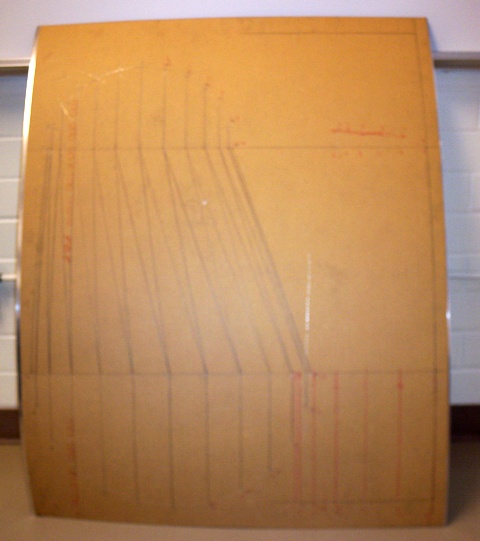

Any ideas for making large 12-20" full sized patterns? It is impossable to find sturdy reusable material long enough. Gasket material only comes in 36" rolls that I can find.

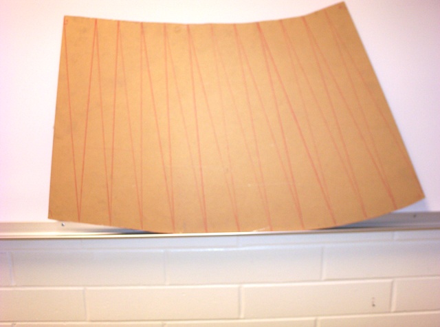

Hello uphill, a number of years ago I had a couple of students come in and take a fabrication class from me. They worked at one of the local nukes in the maintenance department. I normally make patterns out of some really heavy kraft paper. They brought in some kraft backed aluminum roll sheeting to show the students some of the patterns that their journeymen used at their shop. I don't know who makes this stuff but I could certainly see some definite advantages to having something like this around. It was 36 or so inches wide and was taken from a large master roll I believe. I'm guessing that the aluminum portion was probably 22 GA. or so. The paper portion of this made drawing anything on it really easy and then you could use tin shears of one sort or another to easily cut the patterns out. I'll see if I can get some pictures to include when I get back to the school on Monday for you to see and better understand what I'm describing. I haven't looked on the internet for it but you might also be able to locate it there. a little something else for your consideration. Best regards, aevald

Hello uphill, here are a couple of photos of the stuff that we have at the school that I had mentioned in the other post. Best regards, aevald
