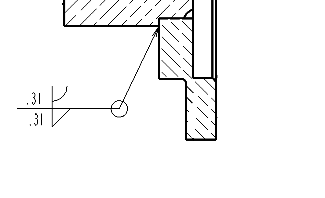

Is it possible to repair a weld on 8620 hardened and carburized to RC 55-60 .062”deep? The bigger question is how I prevent it from happening in the first place. Here is some information on component and WPS; 8620 cold finished round is annealed and is being joined to A36 plate, pre heat shaft 250°F, GMAW, ER70S6, 95/5, 40-45CFH, 26V, .045 Wire, 575IPM, Weave, Travel 9-10IPM. I am inspecting this weldment before it is sent to be hardened usually after 48 hours from the time of welding. The weld is being machined flush no cracks appear present before it is hardened and the weld area is checked with PT. When the component returns from the hardener some of the weldments have cracks usually in the weld interface on the A36 side of the weld, I was told it has always been like that.

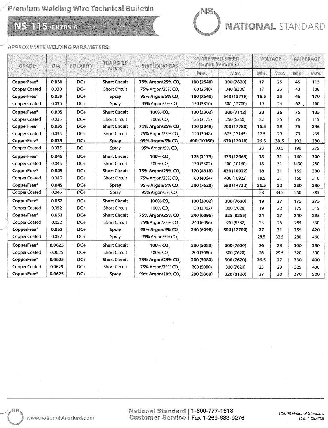

.045 solid wire @ 575 ipm  (someplace close to 400a)  is a little above the maximum any manufacturer even recommends for that type of solid wire.  Add to that the heat input from a weave type deposition and I think process control may be an issue to be addressed.

I think there pushing the size of the weld also in AWS D14.3:2005 7.5.8 Prequalified Procedure for Gas Metal Arc Welding GMAW (4): The thickness of weld layers, except root shall not exceed 1/4”. The welding supervisor gave me this sheet for the wire (See Attached)

With the J-weld prep that is being used, it looks like lack of fusion is a possibility, especially if this weld is performed in a single pass.  Can you use a U-groove prep instead? The higher manganese content of the ER70S-6 does tend to push the weld strength up, so perhaps ER70S-3 would give a little more ductility.  To really understand why they are cracking, you will need to cut one of the parts through the cross-section of the weld and examine for complete fusion or microstructural problems.
