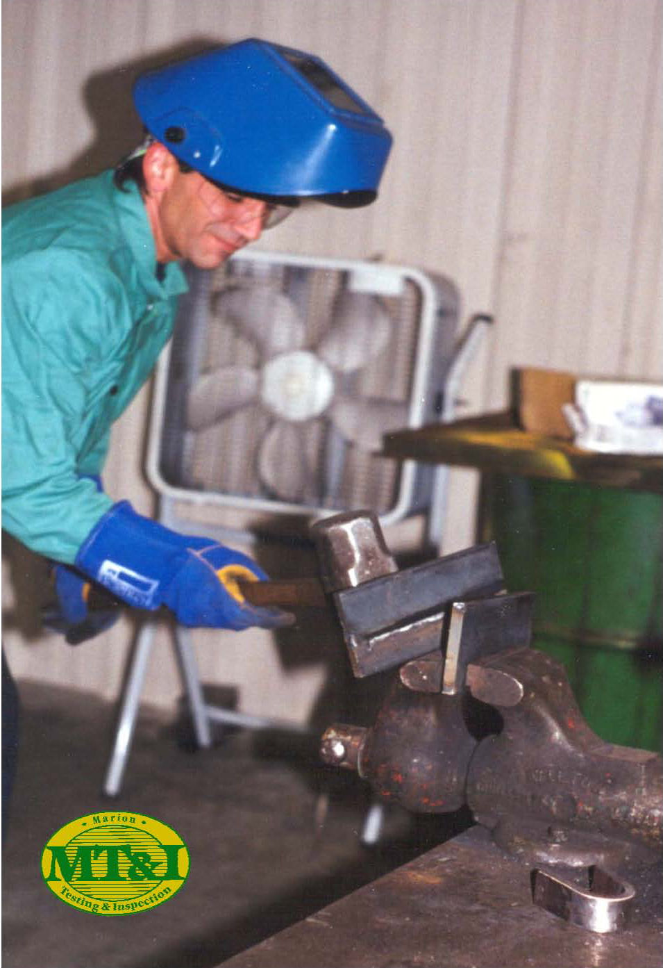

simplest way is using a BFH, easiest way is hydraulic press
Weld fillet weld(T joint), flip it over and break it, verify the root.
(smash with hammer until it folds over on itself or busts in pieces, similar results with hydaulic press)

Parent - - By 803056 (*****) Date 08-19-2010 03:17
This shows it all!
Best regards - Al
Parent - - By welderbrent (*****) Date 08-19-2010 14:40
I think I would dispose of the welding hood while attempting that task.  And my press is so much easier than my 16 lb sledge.
Great Pic though.  Thanks Al.

Parent - - By swnorris (****) Date 08-19-2010 16:24
Brent,
That would take the "sport" out of it.  The welder really should attempt to break it while the hood is still down.
