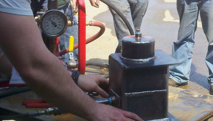

Today are the Wisconsin State Championships for Skills U.S.A.
The welding competition includes student learners invited from all Wisconsin state technical colleges, and features a pressure Vessel that must be fitup and welded by the students.
GMAW (Short circuit and Spray), SMAW (E6010 and E7018), and GTAW (Stainless and Carbon Steels) Oxy-fuel and Plasma cutting are all part of the single weldment.,
They are given plans, metal and turned loose.
Short circuit and E6010 open roots on Horizontal Single bevels. on the 3/8" plate and the pipe to plate. Plus some overhead fillets with short circuit GMAW and E7018 SMAW. Short circuit Vert-up and down on two outside corners and E7018 vert-up on the other two.  I think it's a pretty neat little project.
Pressure tested to 700 PSI   (sounded a little high for a vessel with corners)
The Judging is not completed, but two of my students were the only ones to make full pressure with no leaks! ... They also must be visually inspected, each weld recieves a score and a written exam is also factored into the final talley.
Here is a pic of one of the projects being tested.

Parent - - By DaveBoyer (*****) Date 04-14-2011 03:50
Do the flat surfaces distort at test pressure?

Parent - By 357max (***) Date 04-14-2011 14:28
Yes, the flat 3/8" plate surfaces bend with 1000 psi "WATER" pressure. DO NOT try this pressure test with air!! In fact; make certain certain that there is no air in the vessel. Shake around and make certain certain there is a vent hole to assure no air. Water at a 1000psi will burst a weak weld and the pressure is gone. Absolutely no danger.
