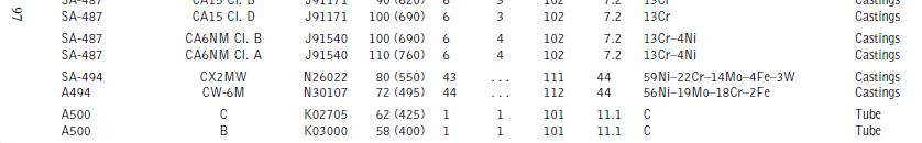

According to section 9 ED. 2011 is specified P43 at page 97, it is surprized me when I saw it, our supply foudry' metallurgists told me that, it can caused by cooling speed after heatreating or welding. And the trace elements" such as S & P content are in the Code range, we do not know why? I do not have a copy of CMTR now, and how to attached to forum.

I am not sure if your ASME IX is different to mine, but the only A494 alloys listed are: CX2MW (P43) and CW6M (P44). Grade M35-1 is not in my ASME IX. I will attach the relevant section of the P No listing showing this. It is for this reason that I asked that you make sure if you are welding the correct alloy! If you showed us the material analysis, we can make sure exactly what it is.
Regards
Niekie

You R right about the P number, and finally, I got the copy of CMTR from our supplier, I will attached it and please give an advice.
