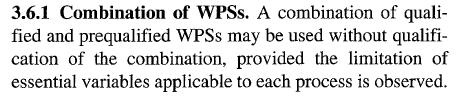

Hi All,
I have a combination welding procedure qualified by PQR. Butt weld joint rooted with SMAW and filled by FCAW. My concern:  Is the WPS qualifies to weld fillet weld with only FCAW process? (within the essential variables). Please help
Parent - - By ozniek (***) Date 11-20-2011 07:57
Hi peterj91
According to my knowledge, AWS D1.1 does not deal with this question quite as clearly as for instance ASME IX, but I believe the answer is that YES, you can use only one of the processes, as long as you remain within all the essential variables. The closest indication of this is found in paragraph 3.6.1. I will attach this so that you can see the wording.
Regards
Niekie

Parent - By ozniek (***) Date 11-22-2011 12:21
Hi nantong
Thanks a lot for the interpretation that you have shown us below. I do not have copies of the AWS D1.1 Interpretations, so am not able to go through them for an answer. Can you possibly see if there is a similar question asked in relation to section 3.6.1, and tell us?
I could be wrong here, but my reading of the interpretation you have referenced below is in relation to clause 5.5 of D1.1, so it appears to be addressing a different issue. I will attach 5.5 for reference. I believe that what the interpretation is saying, is that if the welder has a WPS, he must follow it, and may not change anything to it. (Like leaving out a process.) In the context of 5.5, I do not see how it refers to the omision of a process if a new WPS is drawn up.
Possibly a search on the interpretations of 3.6.1 will shed some light on this.
Regards
Niekie
