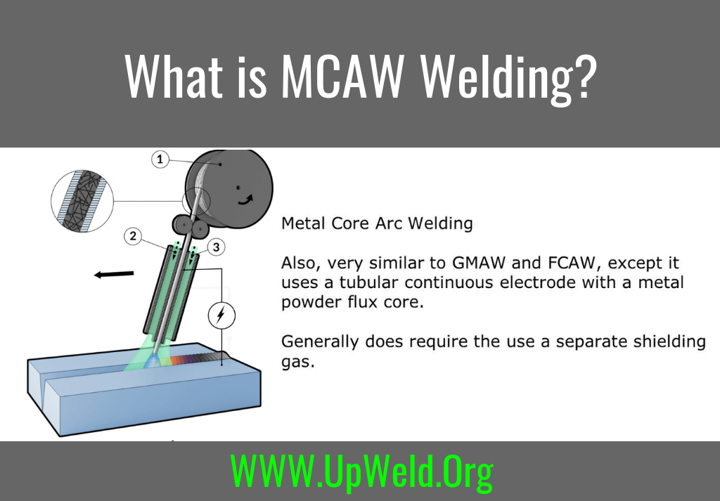

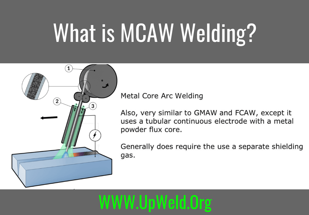

Parent - By UpWeld Date 11-24-2018 05:58
Here you can read What is MCAW Welding? https://upweld.org/what-is-mcaw-welding/ i think its helpful for you
